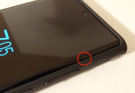

Reinstalled mine yesterday and everything was perfect except this one little spot near the edge. I think I pulled a little glue out wiping with the alcohol wipes.
Will this spot get worst over time? Can this be fixed by adding a little bit of the LOCA glue to the edge?
I would pour a some LOCA on a piece of paper, then, using the corner of a piece of paper or needle, dab it in the glue, tap that little area, and cure with the UV light.
Just fixed it and now it's perfect, worked fantastic.
